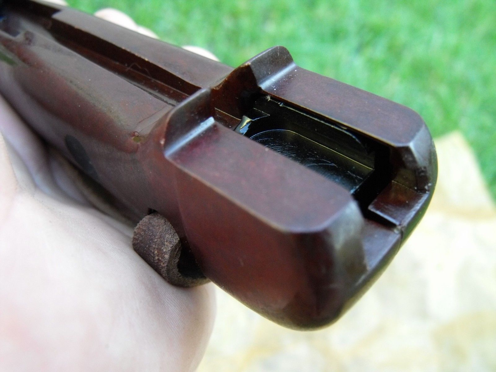

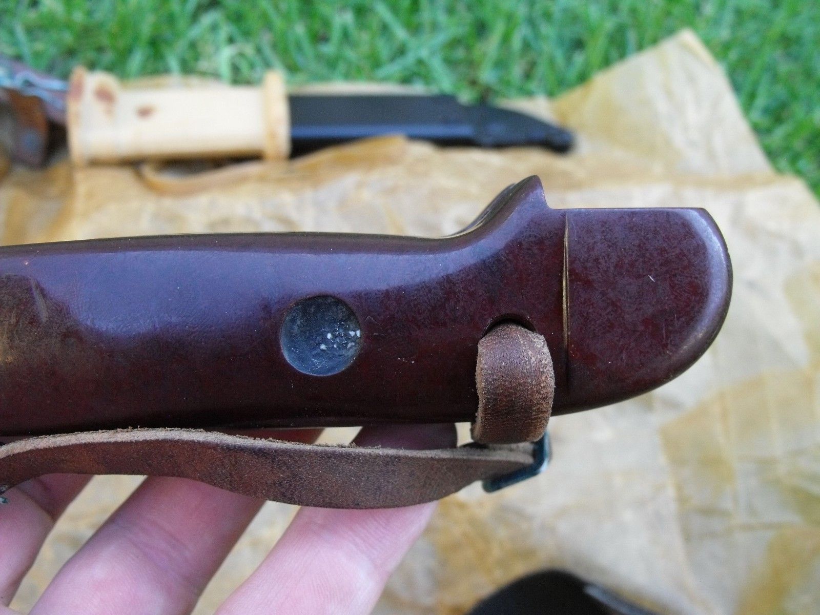

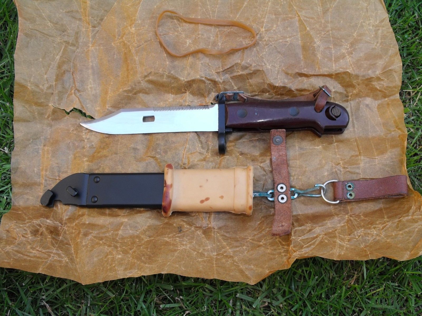

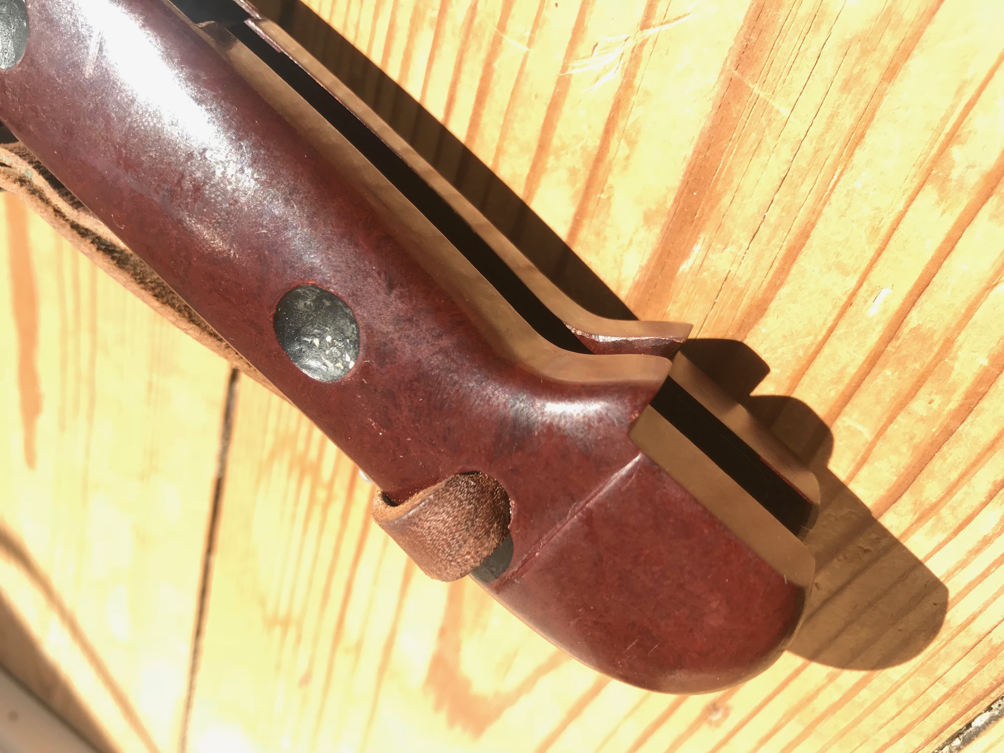

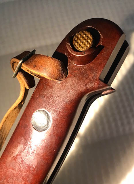

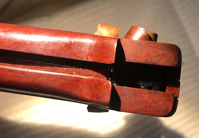

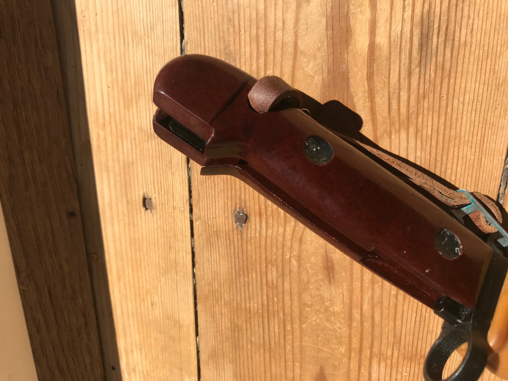

I noticed this, "New, in the wrap", Hungarian AKM 6X3 Type I bayonet and scabbard with modified pommel on eBay recently. This modification has been around for some time. Usually it is found on used or reworked Hungarian and East German bayonets. Pictures and information about this modification can be found in several references. Sometimes the work is very crude and other time uniform and professionally done.
One has to question why the Hungarians would redesign the molds and assemble the modified style grips on new bayonets at this point in time.
Perhaps to upgrade new old stock bayonets or to produce new bayonets for the international market using the existing obsolete machinery? M.

If i had a milling machine i will do hundreds of bayonets like that (a bit of sanding and polishing and job is done).
I saw many years ago some bayonets like that but i'm still asking myself how it could exist new bayonet with milled grips...

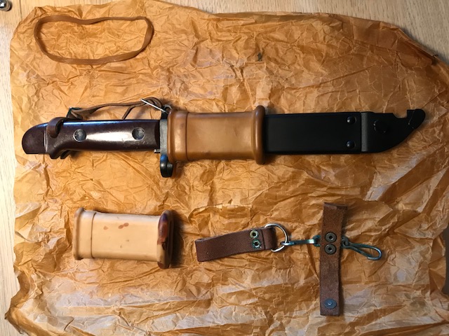

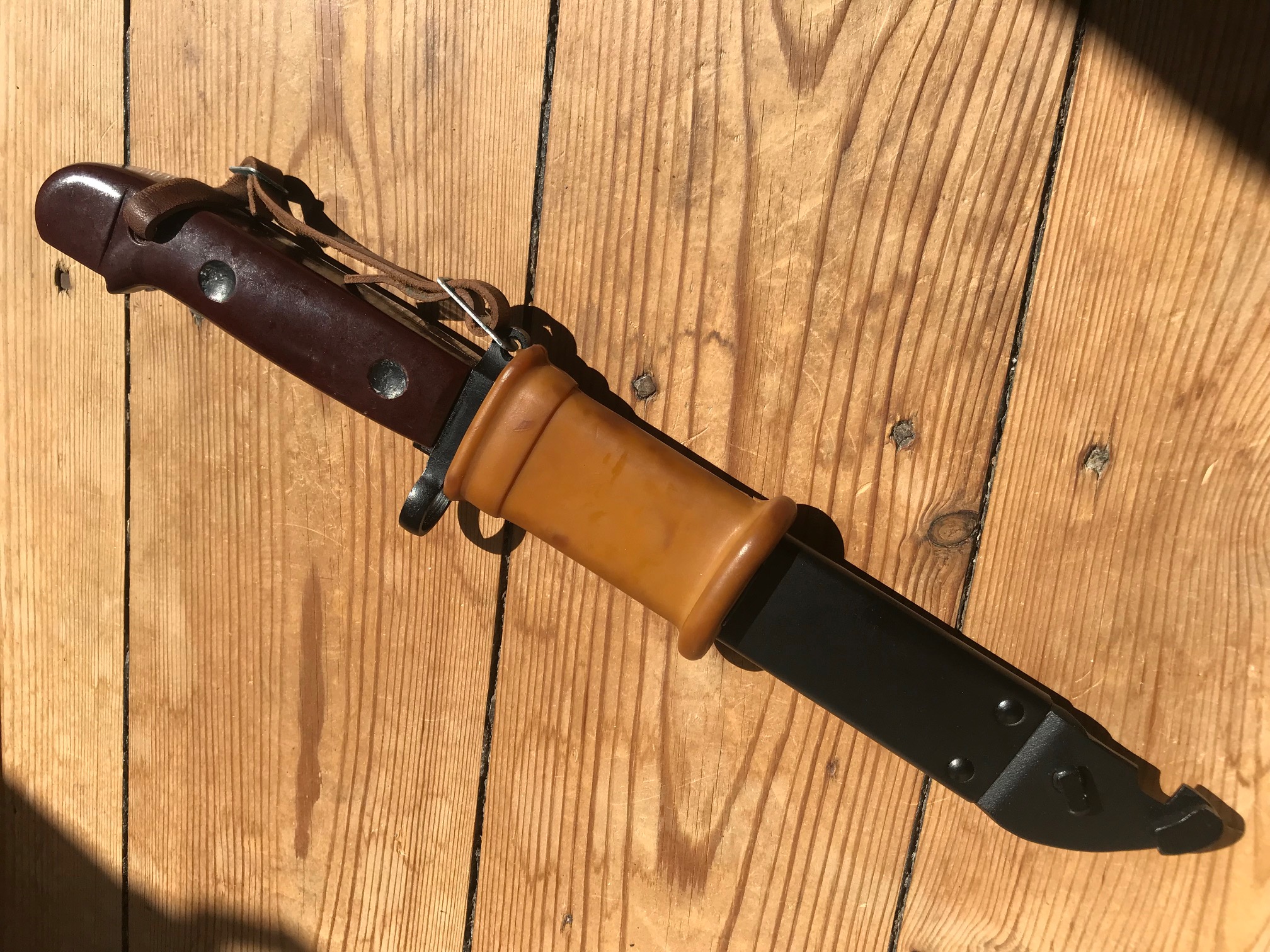

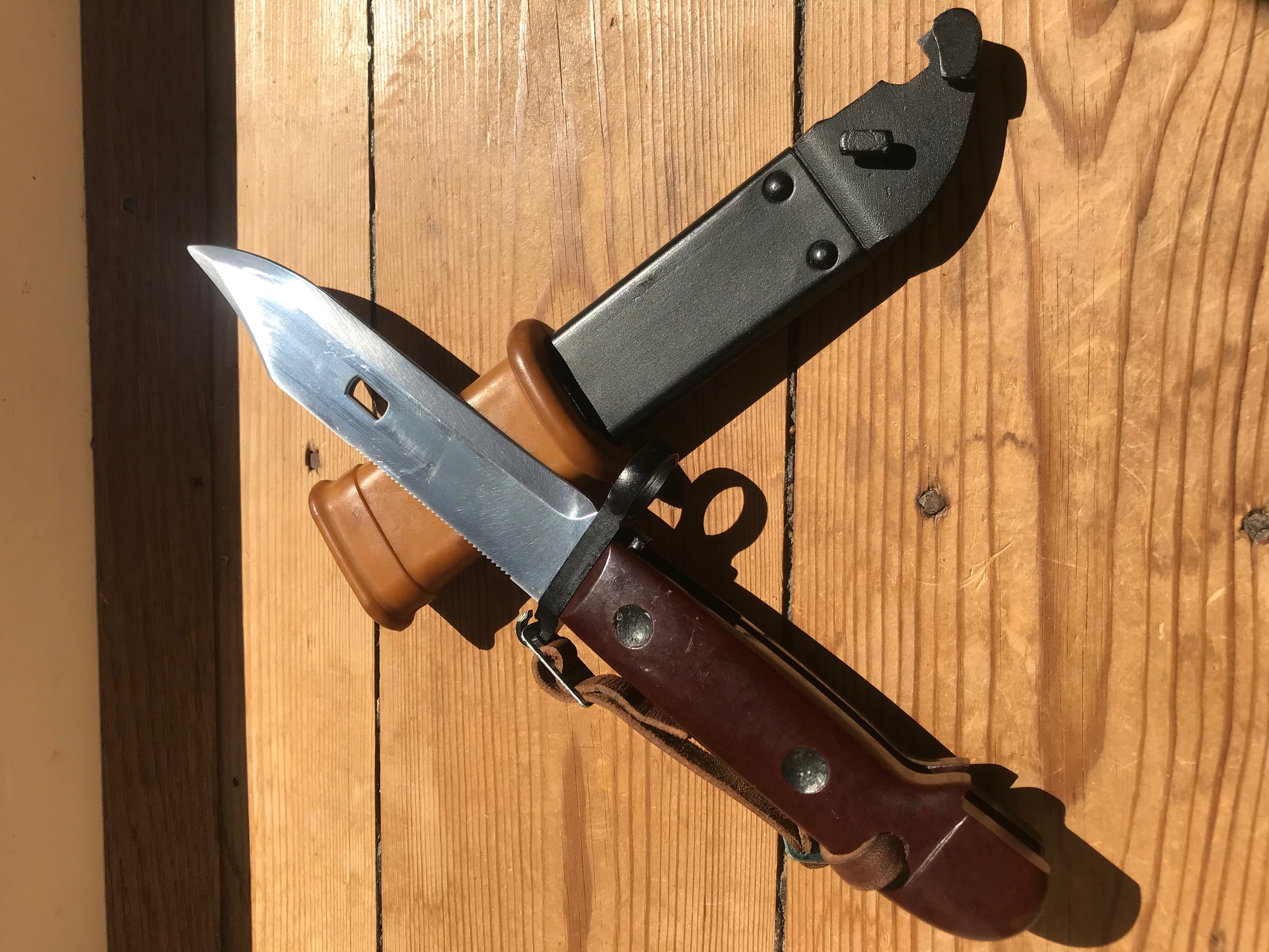

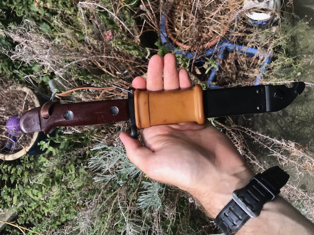

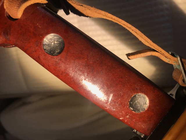

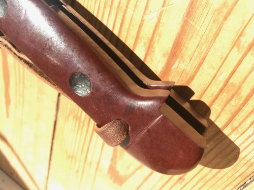

I bought this one after a few considerations. Price was high, but lower than stated on ebay. Received today. In original wrap as stated and in excellent condition except for the insulator. Luckily I got a spare from the seller in Hungaria.
Btw this is my first post - so hi
Jacob
Jacob

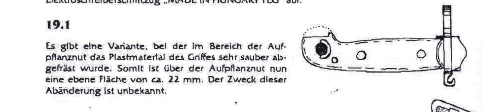

I found a reference to this modification in a German collectors book. "Das Kalashnikow Bajonett" by Ulric Seidemann, (2002). It is in the Hungarian section. The text translation is: "There is a variant in which in the area of the planting groove the plastic material of the handle is very cleanly cut off. Thus, over the planting groove is now a flat plane of about 22mm the purpose of this change is unknown." Mike

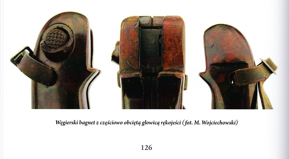

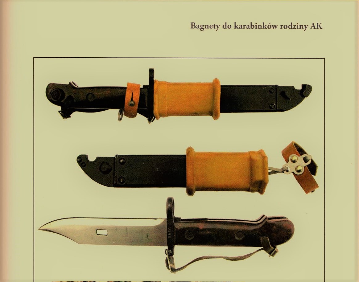

Here is another set of pictures and information from a Polish book, "Bagnety" by Zbigniew Gwozdz (2012). These pictures and accompanying text were found in the Hungarian section. This is the Polish text followed by the translation:
"W niewielkich ilosciach spotykane sa rowniez bagnety wegierskie z obcieta glowicowa czescia rekojesci. brak jednak blizszych informacji czemu ta modyficacja miala sluzyc. Istnieja przypuszczenia ze bagnety te mogly byc stosowane w karabinkach feg-ngm zaopatrzonych w szczelinowy tlumik plomieni."
"In small quantities, there are also Hungarian bayonets with a reduction in the part of the handle. However, there is no closer information about why this modification was to serve. There is a suspicion that these bayonets could be used in FEG-NGM carabiners equipped with a gap-type flint muffler."
From this translation I would understand perhaps to fit a shortened version of the AKM and/or with some type of muzzle attachment. Maybe a compensator, flash hider, silencer or grenade spigot? Mike

Re: Hungarian AKM 6X3 Type I Modified Pommel?

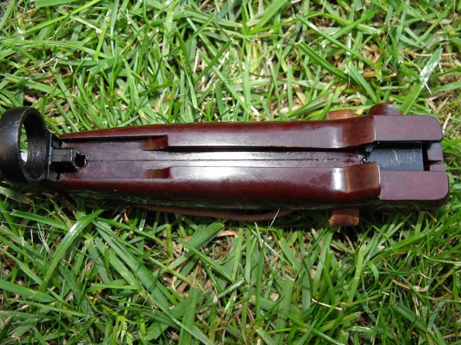

this one look suspicious to me... the one owned by Mike look good (perfect fishish, square machined and polished)
This one seems "hand made" with file marks and not parallel with the guard...

Possibly it was “handmade” on a later note?. Some of these bayonets were perhaps made this way from the start using a different mould, and others were modified later under more crude conditions by hand. That could maybe explain the unparallel areas.

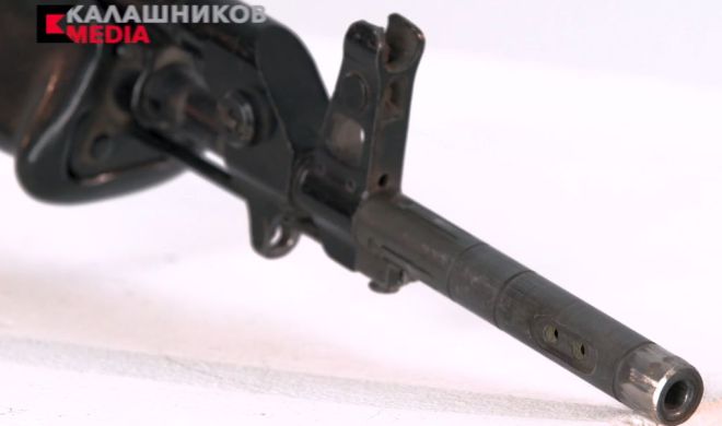

But after a few google searches this info comes up:

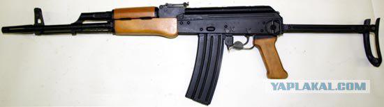

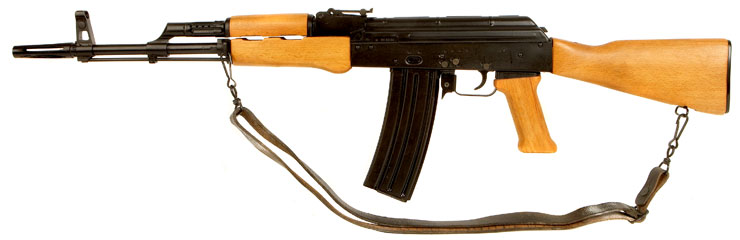

Hungaria did actually produce an ak74 type rifle, designated the NGM-81. It was briefly produced between 81-90. used internally and also offered for export which may explain why only few modified export/numbered bayonets were ever made.
Jacob
http://www.hungariae.com/NGM81.htm
https://bashny.net/t/en/207582
http://weaponland.ru/load/avtomat_shtur ... 1/9-1-0-17
Jacob
It's not really an AK74 type rifle because the bayonet lug is on the gas block the NGM81 could fit 6x3 so need to modify bayonet to fit this rifle
It's a copy of an AKM in 5.56x45 so there is no AK74 type rifle (with "zig zag" flash hider and bayonet lug on front sight) made in Hungaria

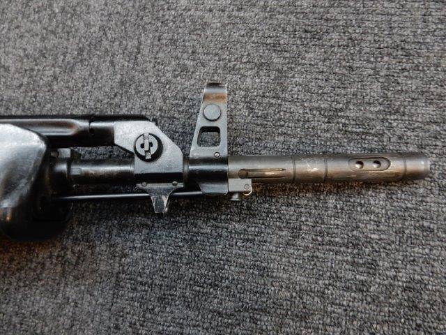

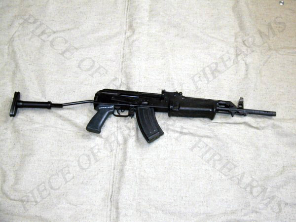

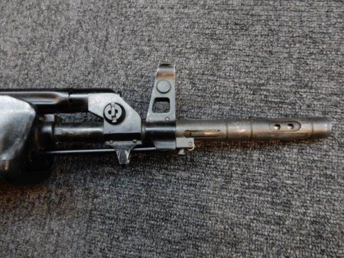

I agree, probably not a FEG-NGM, But how about a first cousin. The Hungarian AMP-69 is a version of the 7.62x39mm AKM, but with a modified with an integral grenade launcher spigot on the muzzle. Is that a bayonet mounting stud I see at the rear of the spigot near the front sight base? Mike
Guys,
I've owned 3 AMP 69's at various times. The little protrusion in the picture at the back of the spigot people are thinking might be a bayonet lug is not. It is a spring loaded pin with a head used to lock the spigot sleeve on the barrel. Much too small to fit a bayonet, plus it is round.
Good to know. Thanks for the confirmation MDI. The pictures I had were not that clear about what the protrusion was. I went back again and found a picture with spigot outer tube removed, definitely not a bayonet stud. Mike
