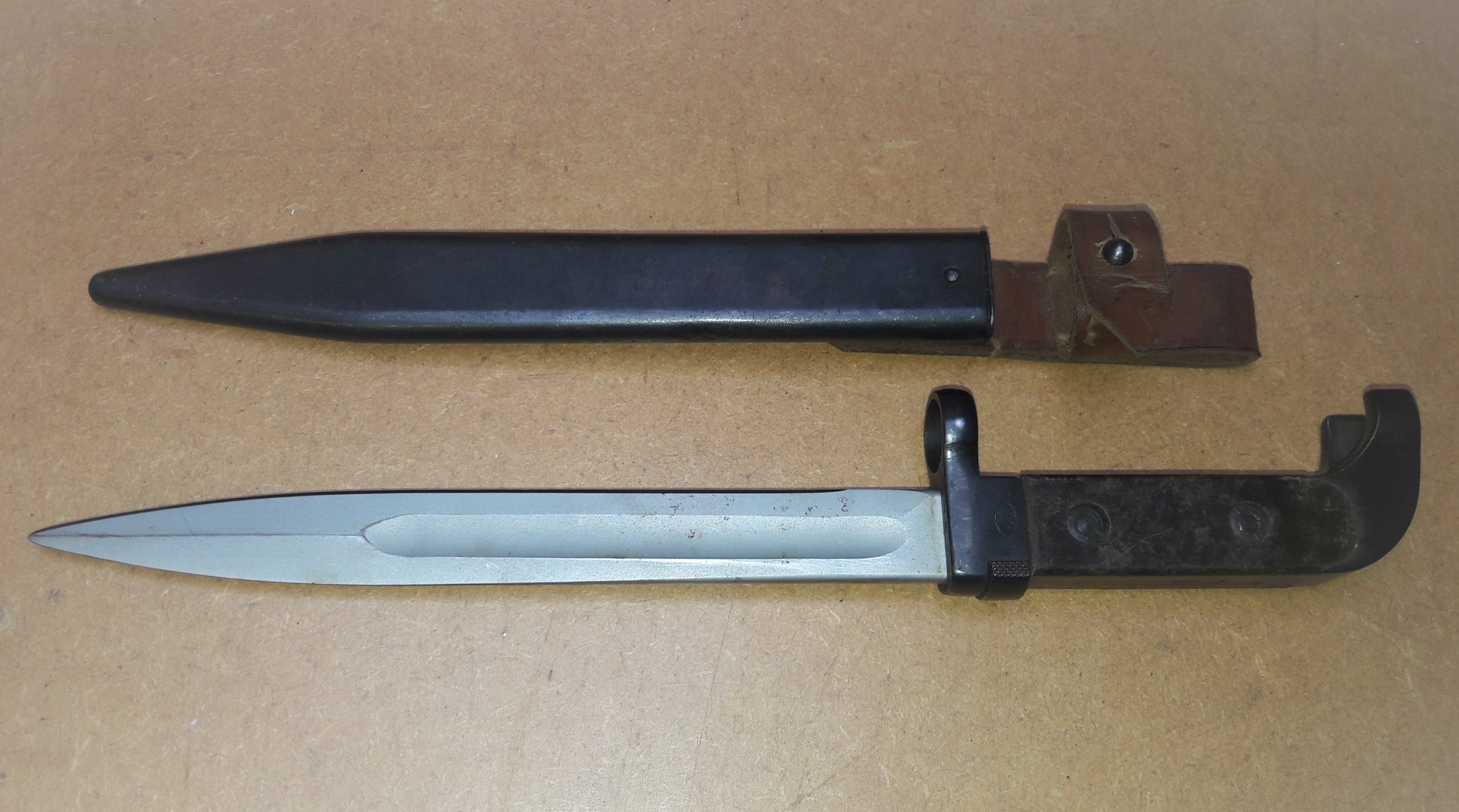

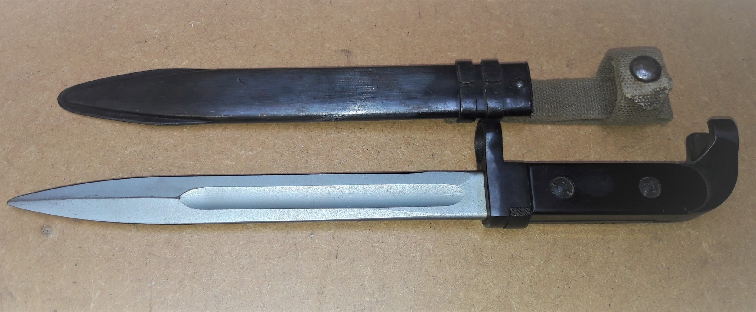

In the meantime, I would be grateful of some help please. I have in my collection 2no AK47 bayonet which I was told when I purchased them, one be a Polish AK47 and the other to an East German copy of the AK47.
Could one of the members please confirm is the description I have been given are correct.
Fist AK47 copy is Polish followed by East German copy

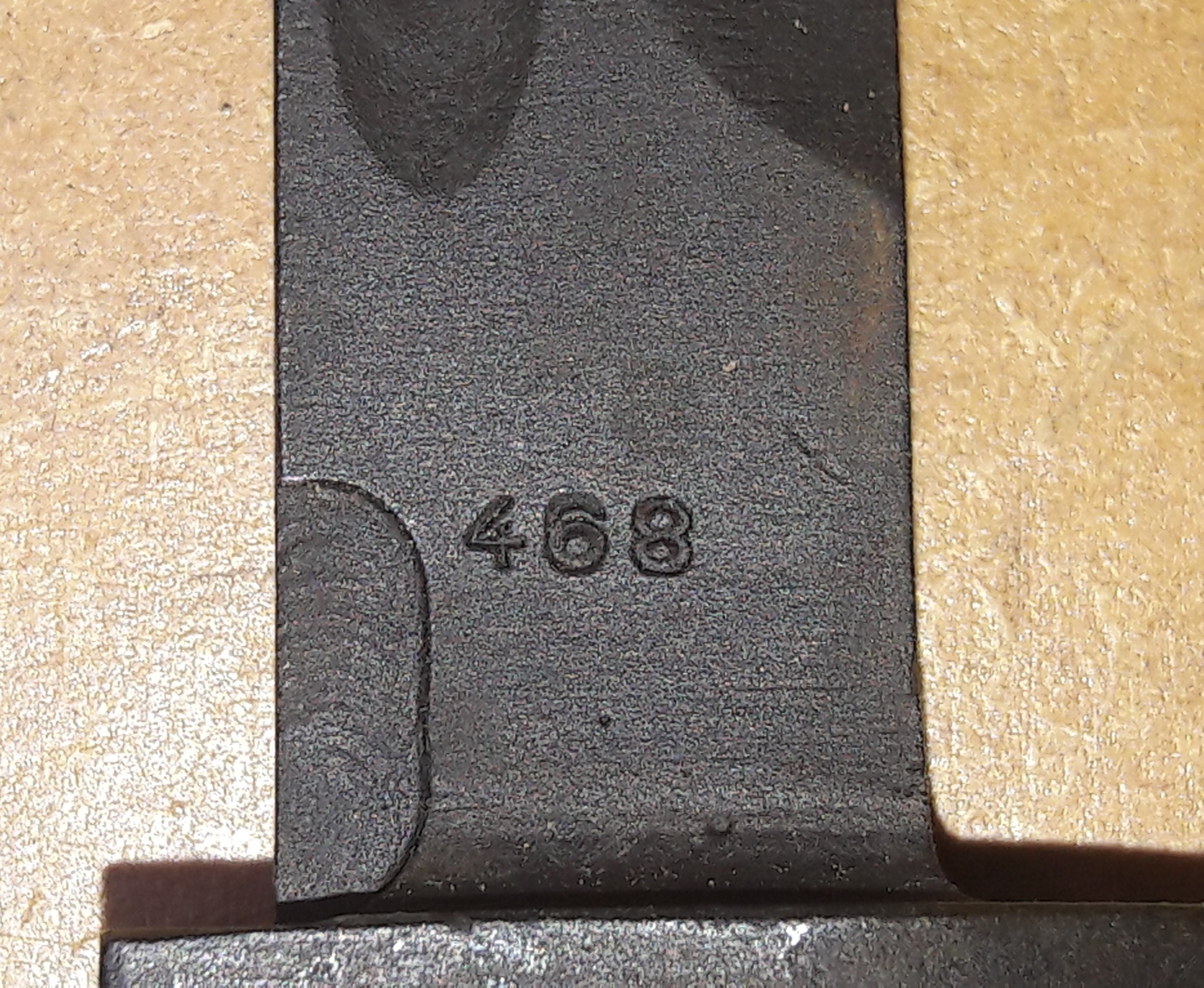

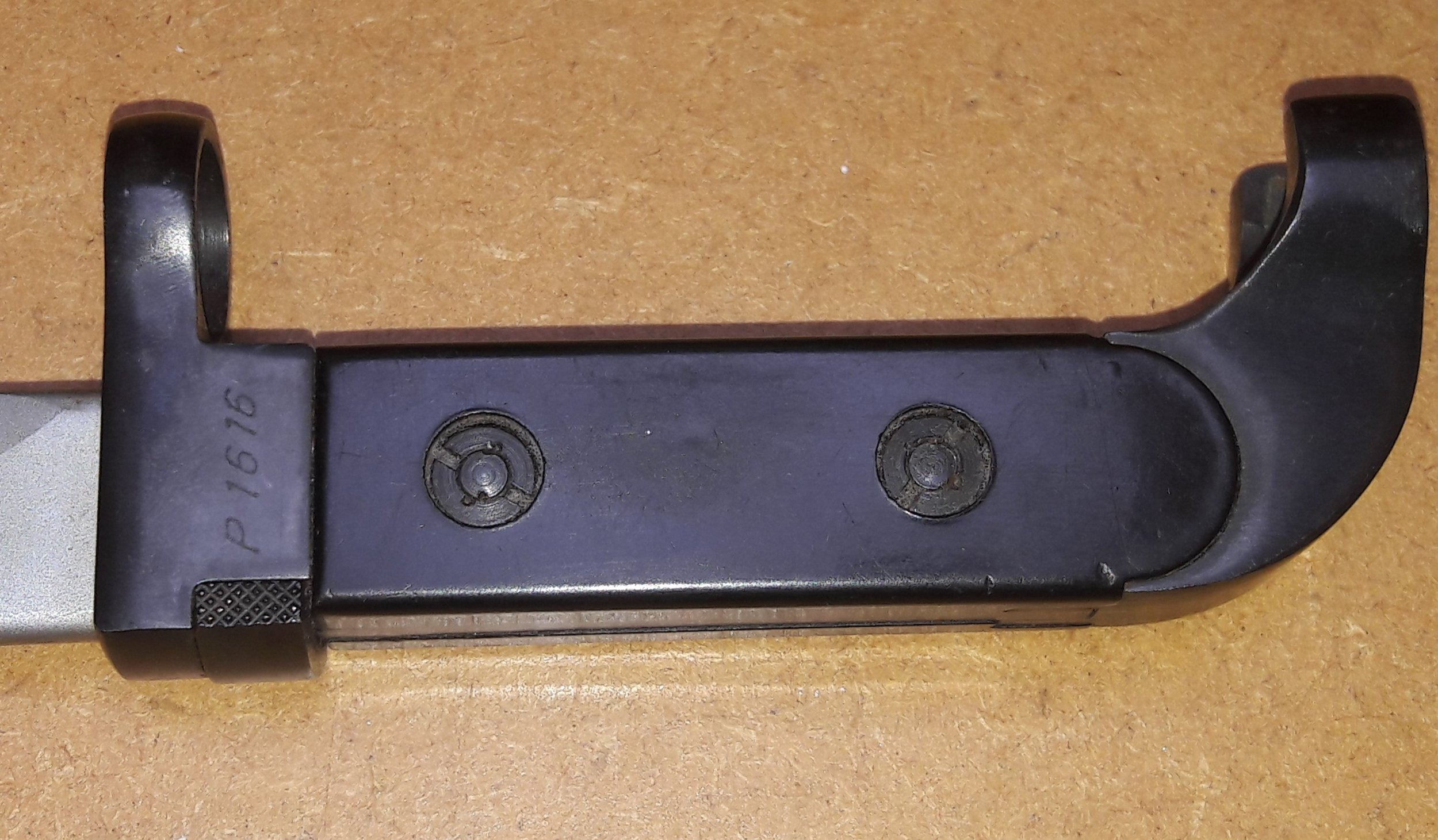

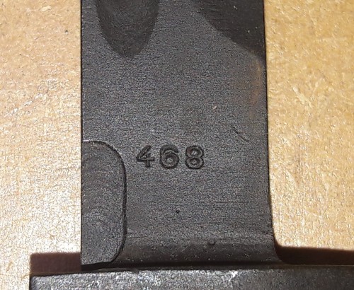

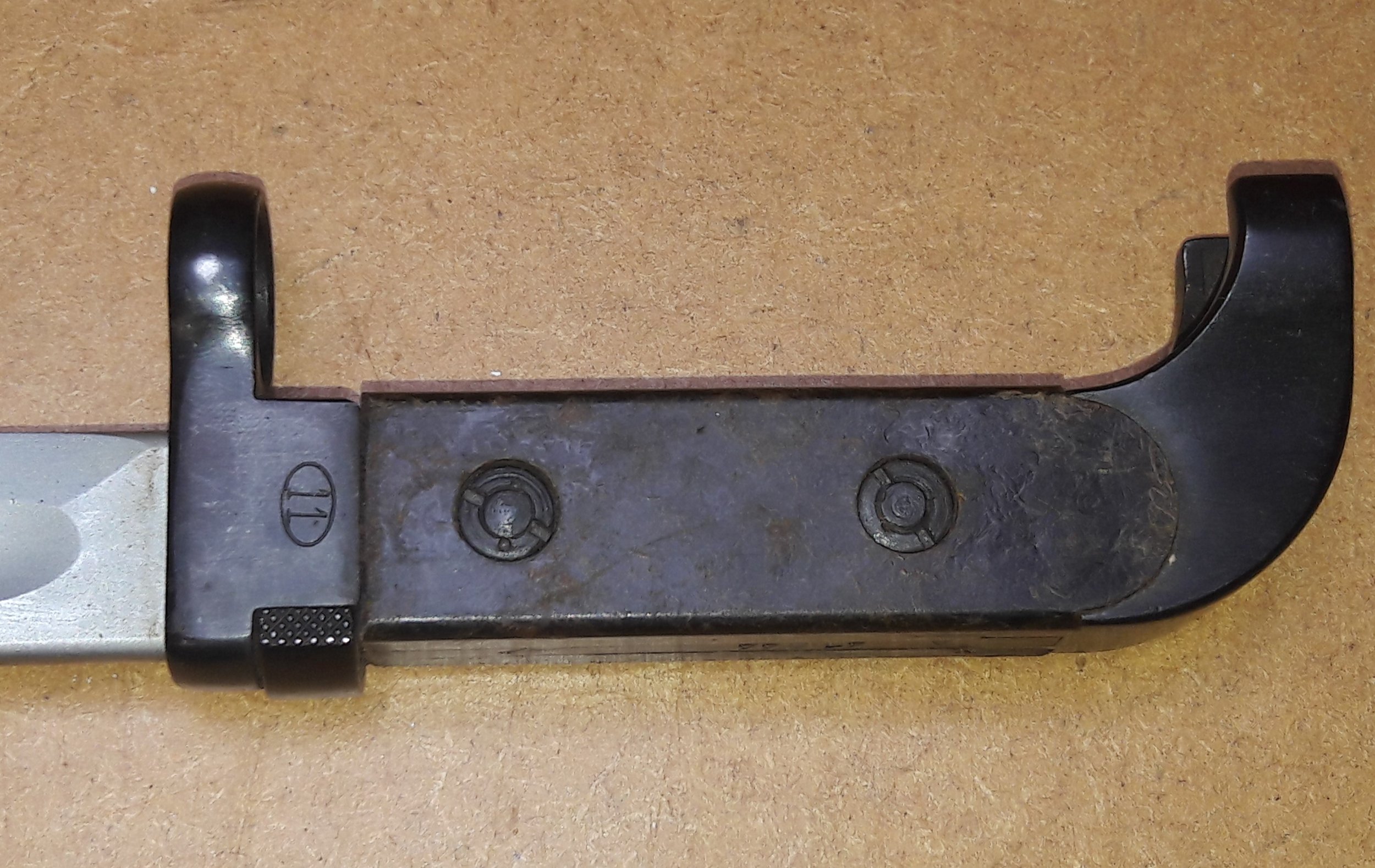

Now to answer your questions. The 1st bayonet pictured is a Czech VZ58 bayonet. I am unable to provide more detailed info about it from the picture, there are several variations. It is not a true Kalashnikov bayonet, but a close cousin so we include it in our collecting. The 2nd bayonet and scabbard are indeed East German, (DDR), AK47 6X2 versions. The scabbard is an early version with the round scabbard spring rivet and hanger appears to be original. Very nice item. The 3rd bayonet and scabbard are Polish AK47 6X2 versions. From the circle 11 placement it is a 1958 variation and the scabbard has what appears to be a correct, original hanger. The bayonet could be a standard "A" variation or a rarer "Z" variation according to the serial number on the bottom of the hilt tang. Another nice item! the older AK47 style bayonets and scabbard are getting harder to find.
Try to look up your bayonets in the individual country sections below. Enjoy!
