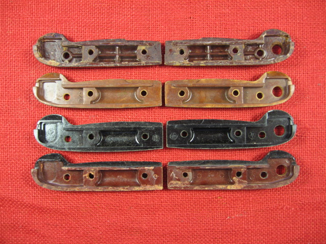

I would be very interested in what you find out about your friend's black Hungarian. As usual you are correct. There were plastic plugs under the smooth dimpled epoxy. However they are not visible unless you remove the sealant. On the early Hungarian military bayonet the sealant is clear and you can see the plastic discs. Here are pictures of the Hungarian grips I painted black and later removed and used for testing. I didn't want to perpetuate a fraud/fake. Also pictured are interiors of 6X3 grip panels. Top to bottom: Romanian, (used), Russian, (new), East German, (new), and Hungarian, (used). Mike
