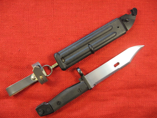

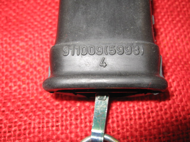

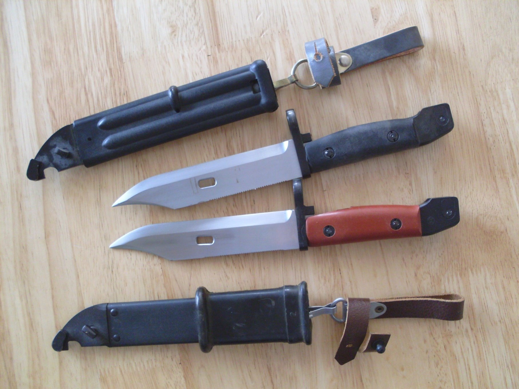

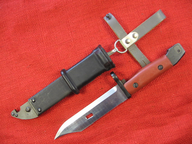

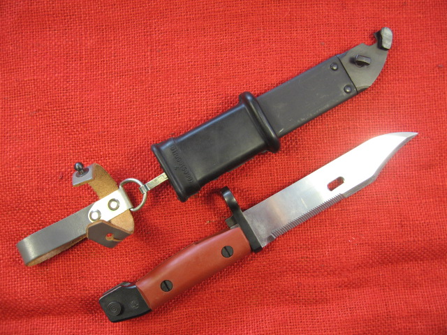

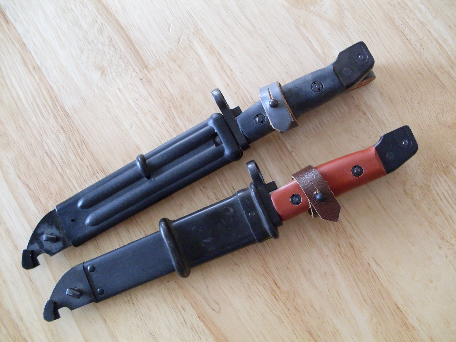

These AKM bayonets and scabbards have been around for a while. Both bayonets are identical except for grip panel color. Not much is known about them and there is a lot of conflicting information and theories. Most recently a member of this Forum mentioned a friend had seen them for sale in a Vietnamese tourist shop, so I went with that. There are others that say they were made, or assembled, in North Korea and several other countries. An other theory is that they were made up from surplus parts for the collectors and not for military use. Some known facts; The scabbards and hangers are East German (DDR) both Type I and Type II wire cutter scabbards are found randomly mixed with both color bayonets. These scabbards have all the original proofs and markings but no serial numbers, (unissued surplus). Both long and short new grey leather DDR hangers are also found mixed with the scabbards and bayonets. One theory is that the blades and cross guards are also DDR, but on close examination I am not sure about that. More on that later with pictures. Also note the black rubber insulator on the DDR Type I scabbard is rather unusual as well. Another important note is that these are AKM wire cutter bayonets, but they are NOT insulated against electrical current. They are solid metal from pommel to point. M.

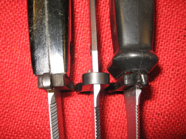

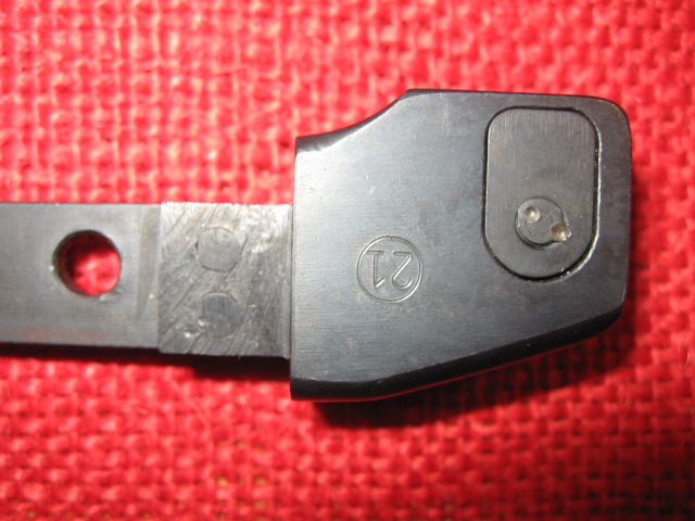

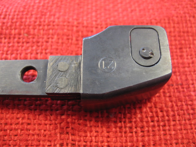

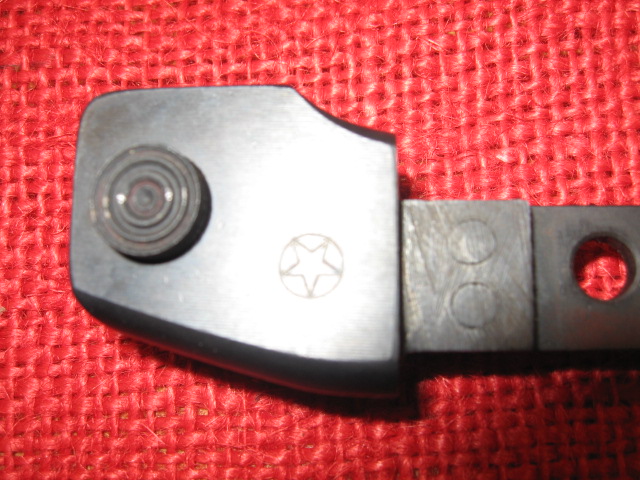

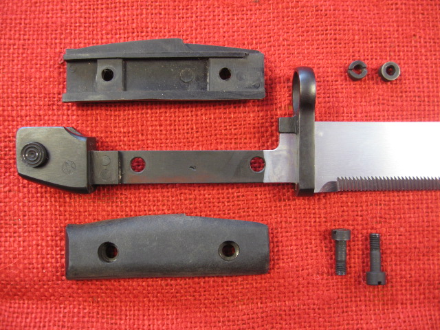

Here are some close up pictures of one of these bayonets disassembled. I don't usually do this and don't recommend it, but my analytical curiosity got the best of me. These bayonets are very well designed and manufactured and of very high quality fit and finish. A small detail I noticed on reassembly is that the heads of the grip machine screws and their nuts are of different thickness and not interchangeable front to rear. This is to make up for the front of the hilt is narrower than the rear. Very over engineered. It would have been much easier and more economical to just use a shorter screw!? M.

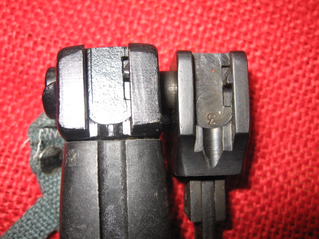

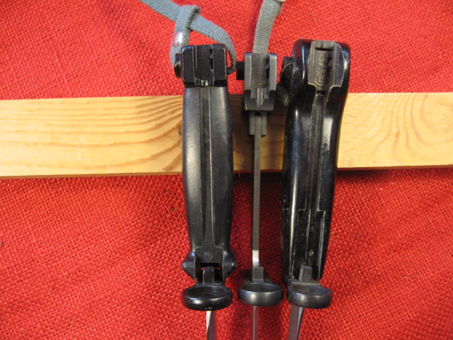

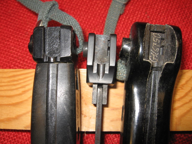

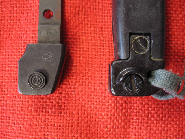

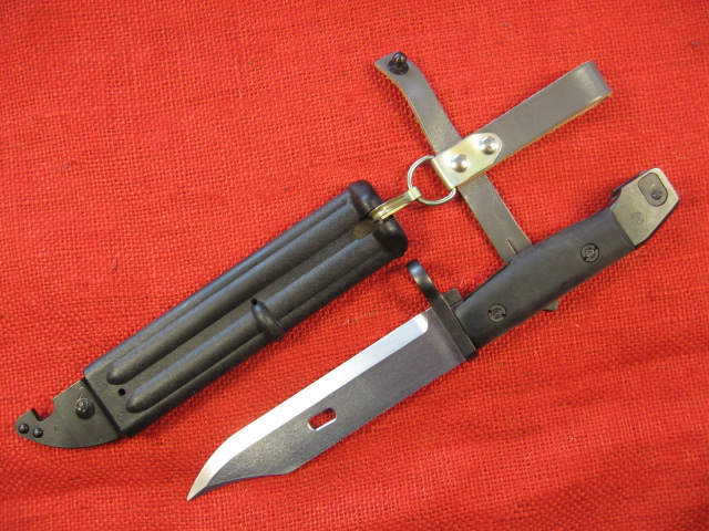

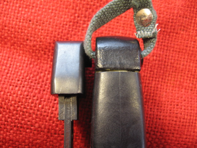

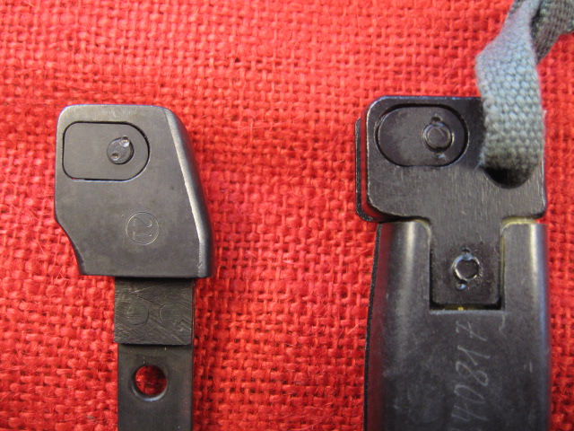

These are a series of comparison pictures between the "Vietnam" AKM bayonet and a East German (DDR) AKM 6X3 Type 1 and AKM 6X4 TYpe II bayonet. The blade tang most closely matches the 6X3 configuration right down to the holes for the grip screws. The Type II blade tang is more centrally located, has one hole and is much shorter, just past the mid point of the grips. The pommel is a completely different shape than the one inside the bulbous Type I grips. It is narrower than the Type II pommel and has a different shaped catch, oval vs flattened on one end. Also note that the release button does have the DDR circle pattern, but no slot. M.

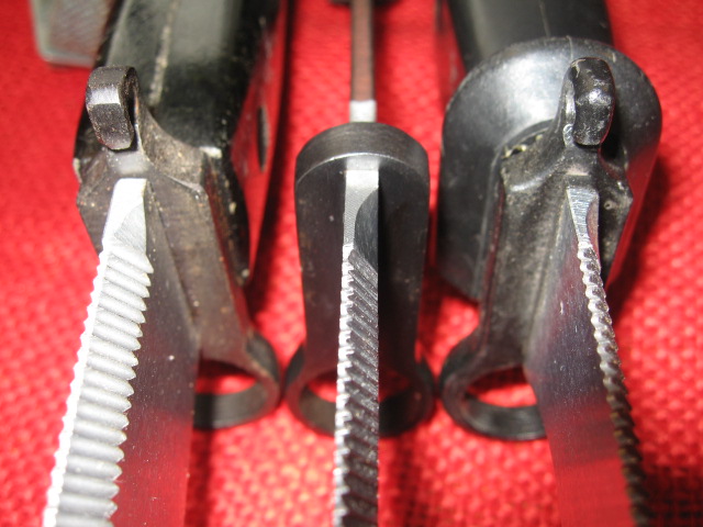

More comparison pictures. M

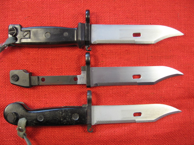

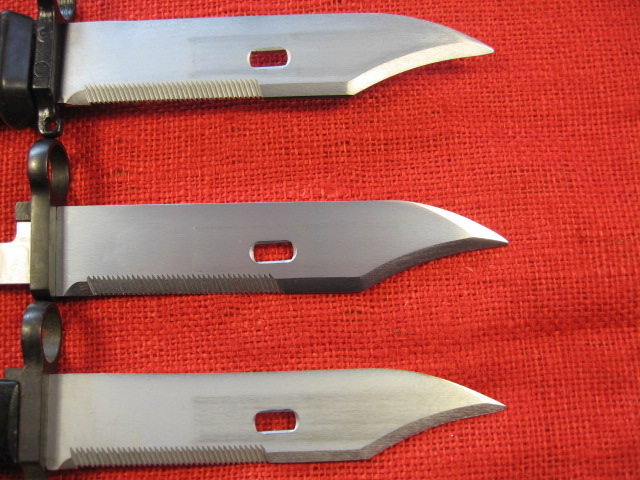

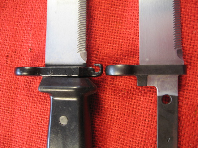

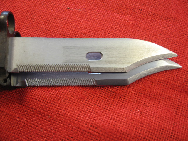

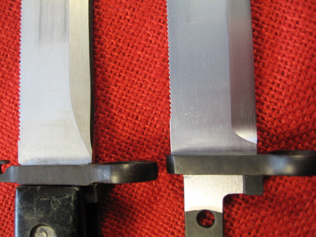

Now for the blade comparisons. Many believe that cross guards and blades are East German 6X3 Type I. However I now question that theory. The cross guards would have to had been machined from blanks. If the completed DDR cross guards were used with just the hook removed they would still narrow down to the hook area where as the Vietnam one is full and rounded below the edge of the blade. The blades are different on several points. One is the blade point area it's self. The machining and beveling are different on the point, edge and false edge between the two DDR bayonets,(both 6X3 and 6X4), and the Vietnamese ones. The number, shape and orientation of the saw teeth are different. Notice that at least two of the forward saw teeth grooves point at the pivot hole, whereas none of the DDR ones do. A more major difference is the beginning of the machining of the edge bevel near the cross guard. M.

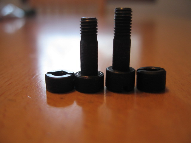

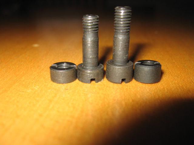

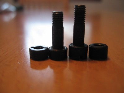

Here is a final picture showing the difference in the grip screws and nuts front to back, left to right. they do not interchange!
Overall a very high quality, well engineered and manufactured bayonet and wire cutter. even though not insulated against electric current. M.

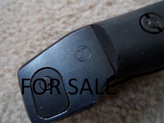

Here is a borrowed picture of the "Vietnamese" AKM bayonet with the circle 27 marking. I believe the circle 21 and 27 have also been observed on assorted Bulgarian ordinance as well as these bayonets. Could this have any significance or just a coincidence?

Both of mine (red grip/black grip) are "circle 21" marked. There seems to be some certainty that these were imported to Europe as "knives" sans scabbards, from Vietnam per Stottman. The question here is were they just referred to as "knives" by the exporting country because they lacked a scabbard (again, per Stottman) or were they true knives which were later modified into a bayonet configuration? It sounds to me they were imported in the present configuration. I was unaware they arrived on the scene so recently (2006). The amount of effort and expense to retrofit this "knife" into a bayonet would probably not justify the cost to do so. I agree the "circle 21 & 27" markings certainly resemble Bulgarian arsenal markings. It is possible these bayonets were made elsewhere and sent to Vietnam as a limited run for trials, etc. Still, I can't help wonder about the similarity of the general design (other than the blade) having a close resemblance to the N.Korean AKM bayonet. Not long ago I bought a Vietnam war era synthetic belt/buckle from a Ebay seller there. He sells a lot of militaria. I am going to post him with some photos of this bayonet and see if he has any knowledge about it and/or what the original scabbard may have been...

21-in-circle and 25-in-circle are known Bulgarian arsenal marks. I've never seen a 27-in-circle associated with a Bulgarian Arsenal. Doesn't mean there isn't one, I've just never seen it.

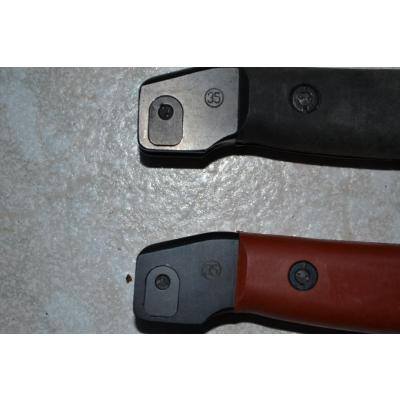

Recently saw a couple of these with circle 35 markings. One red grip version and one with black grips. Mike
Re: Vietnam AKM Bayonets (?)
My red is 21-in-circle and my black is 35-in-circle marked.
