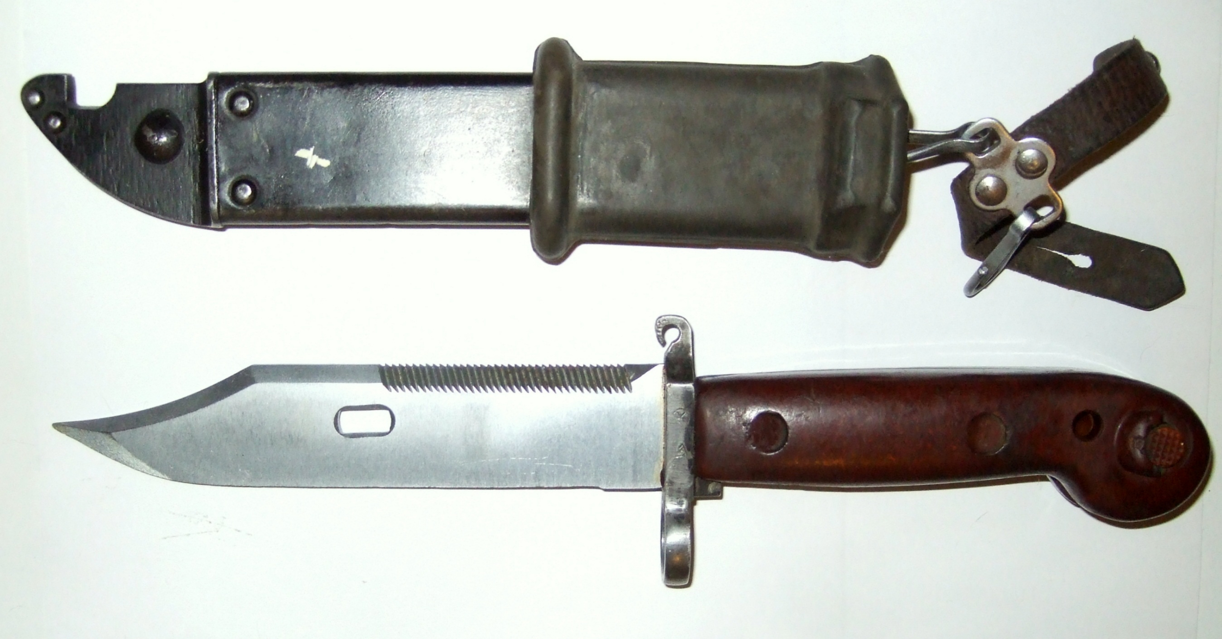

Is this a Romy thin/narrow pommel?

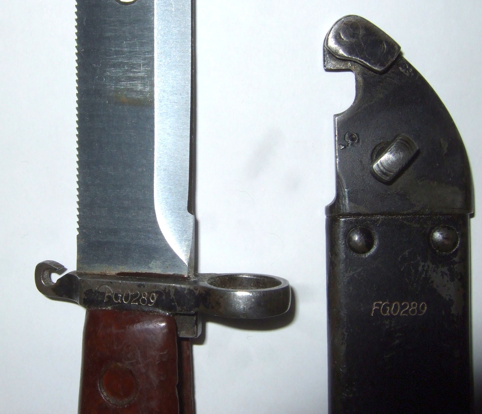

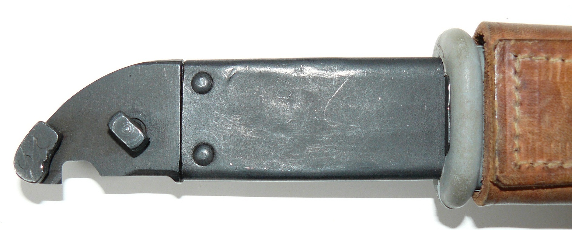

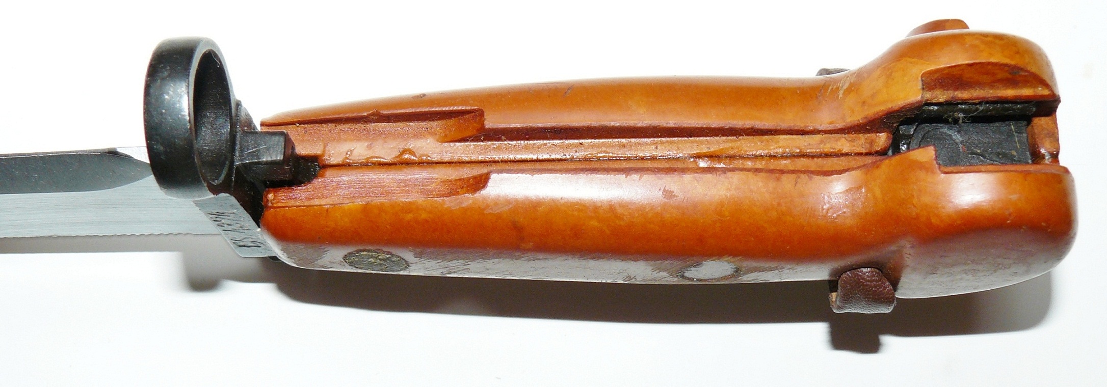

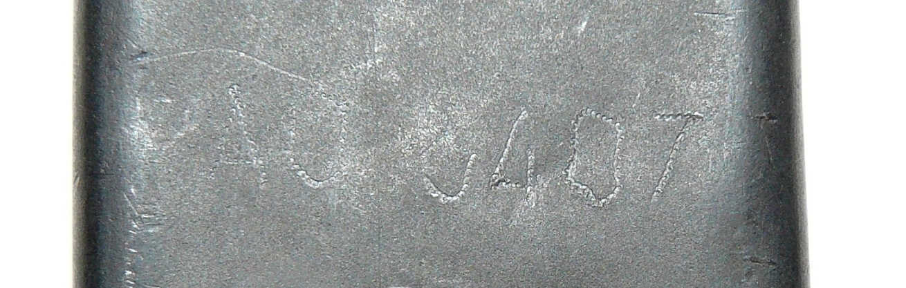

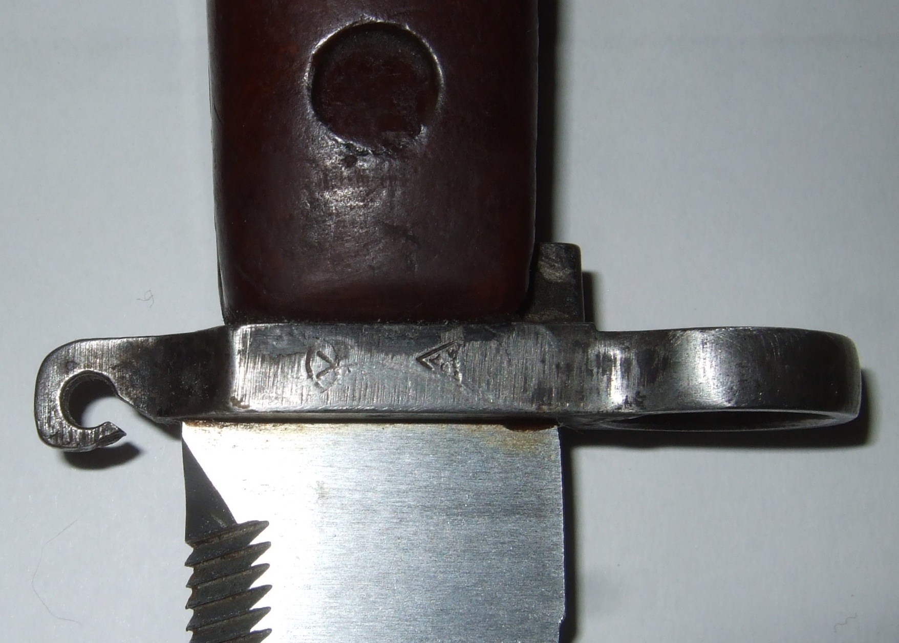

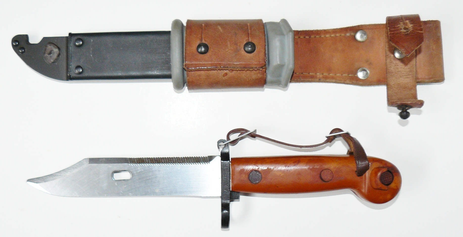

Picked this one up off an overseas auction today, in the hope that it is one of those earlier narrow pommel Romanian Type 1's.

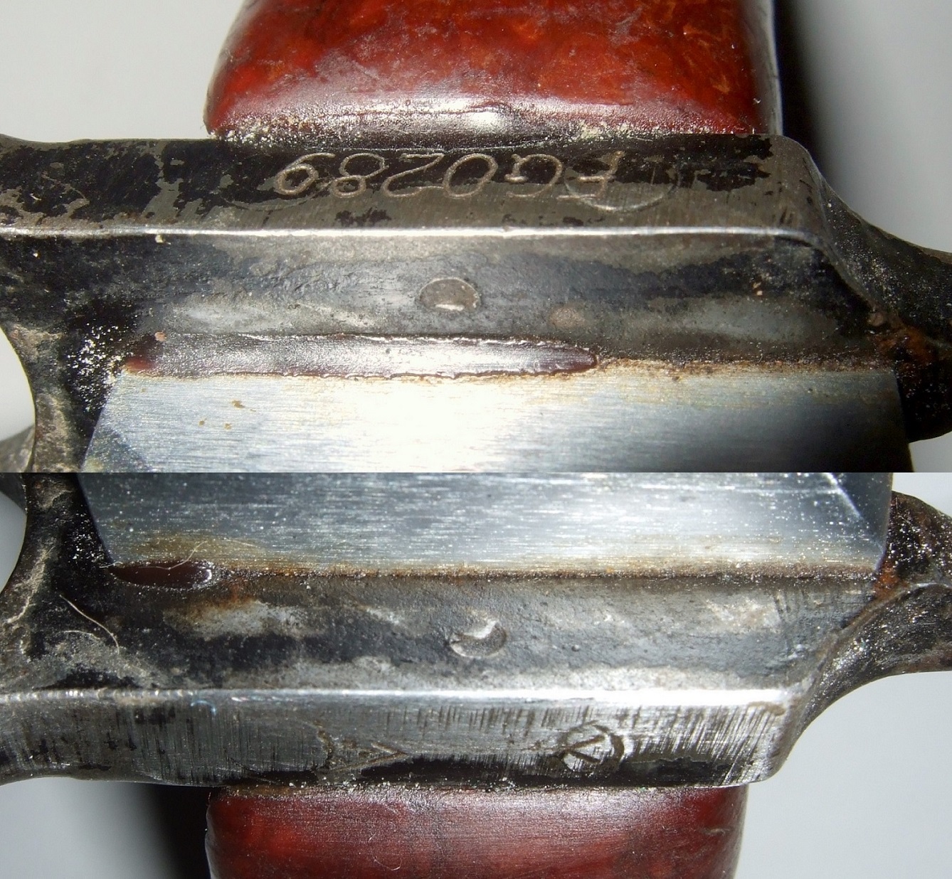

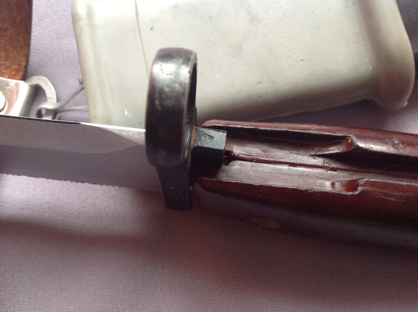

The serials and insulator are correct, but I am not familiar enough with the markings and other features to tell for sure. The arrow in triangle marking on this one are indistinct, and wanted to check that it wasn't a Russian one that had been serialed in Romania. It lacks the unpainted grey welding spot too, but has some interesting markings. I just read that these do have black painted scabbards, so perhaps that is correct. Be a while before I receive it, so wanted to maybe get some thoughts. Hanger isn't the usual 2 piece one..replaced?
Thanks,
Re: Is this a Romy thin/narrow pommel?
From the pictures, it sure looks like a flat pommel Romanian to me. Romy markings are difficult, but what I see appears to be Romy and no Russian ones. The button ridge and the small crease on the opposite side of the pommel appear to be the more squared ridge version. The last picture above also confirms it to me. Notice the small ramps from the center channel to the top edges of the grips on the right side of the picture. They don't match from side to side and this is common with the flat pommel grips. Also, most but not all of the flat pommels have black painted scabbards. Exceptions seem to be when the paint is worn off or removed or if the scabbard has been replace for any reason. The flat pommels usually have circular wear marks on the sides of the cross guard from either a single or dual hook hanger which is hard to see in these pics. the hanger could well be correct as usually these are found with one of the hook styles. Also I've noticed the most of them also are found with the light gray insulators.
Best of all this bayonet and scabbard have matching serial numbers! I don't remember seeing the AB prefix on the flat pommels before and the three digit number is also rare! The person with the knowledge on the Romy bayonets is member Big Uno, perhaps he can provide more detailed information on this item!? Mike
Post by furtium »
Yes, definitely Romanian per Mr. B. Cugir arsenal mark on pedestal seals the deal. Nice serialization! My two examples are serialized ST 1553 and EF 0879.

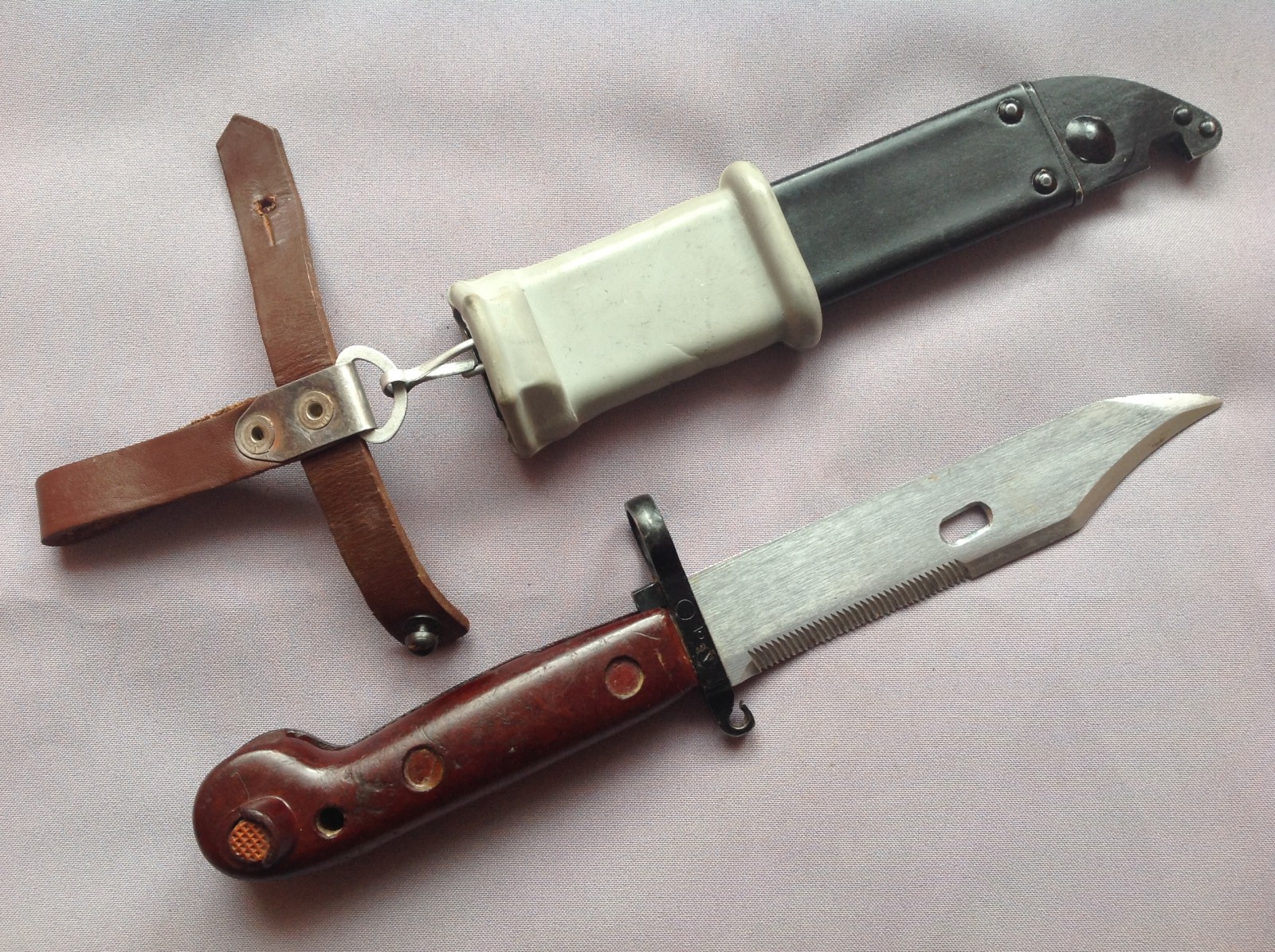

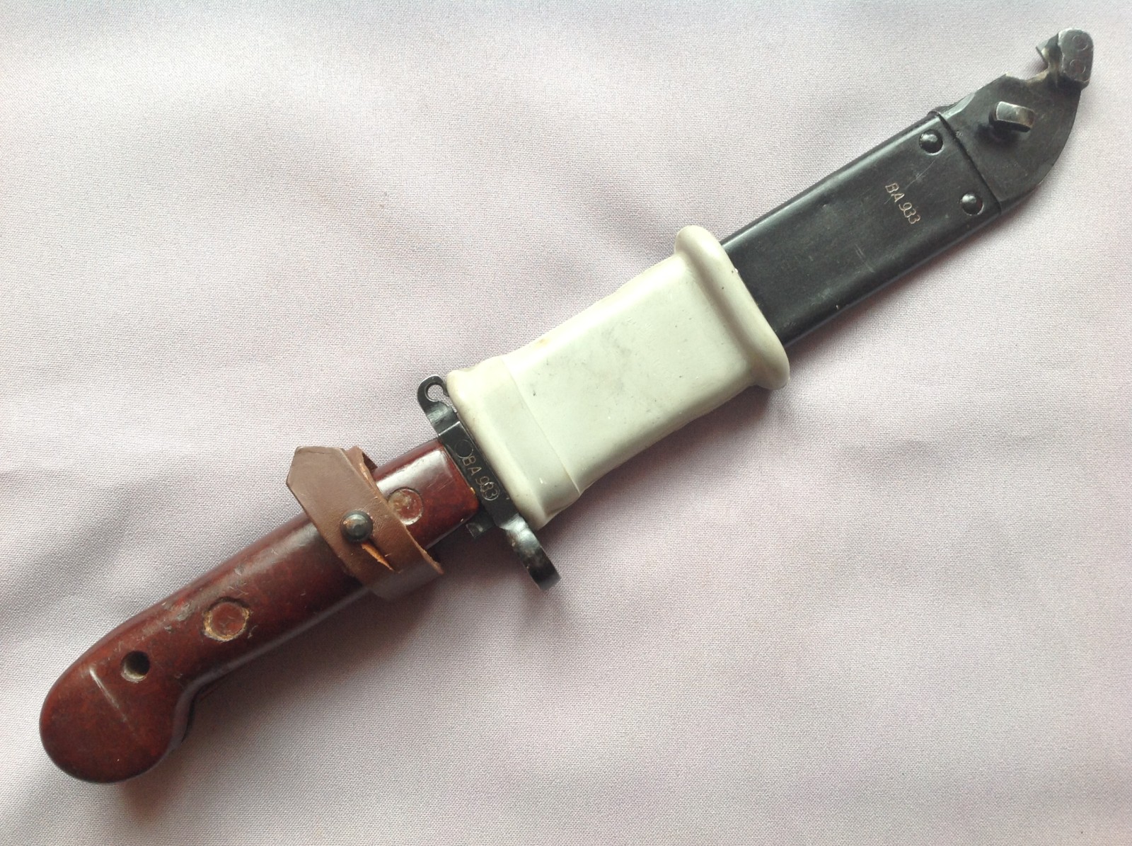

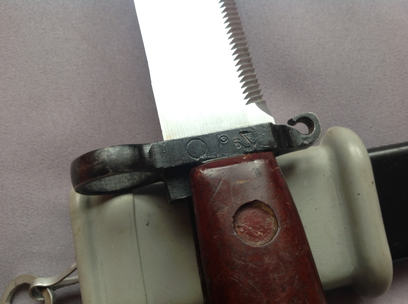

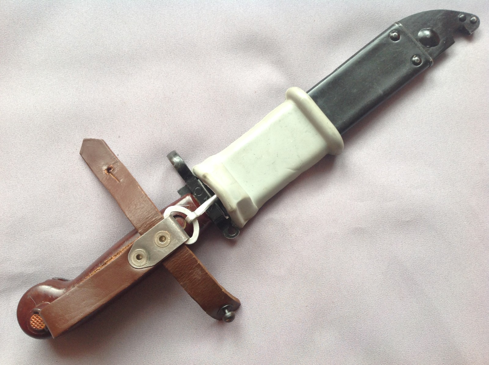

I am not sure who ended up with this excellent example of a Romanian AKM 6X3 Type I Flat Pommel Bayonet with matching scabbard. Who ever it is, I hope they display it with a proper correct hanger. Please note, as with most flat pommel bayonets, they are early production and came with either the one or two piece hangers with snap hooks. As evidence observe the semi-circular wear, (scratch), marks on the side of the cross guard that come contact with the snap hook. The fabric and leather hanger above is a much later style and is also sought after because of the fabric color. Mike

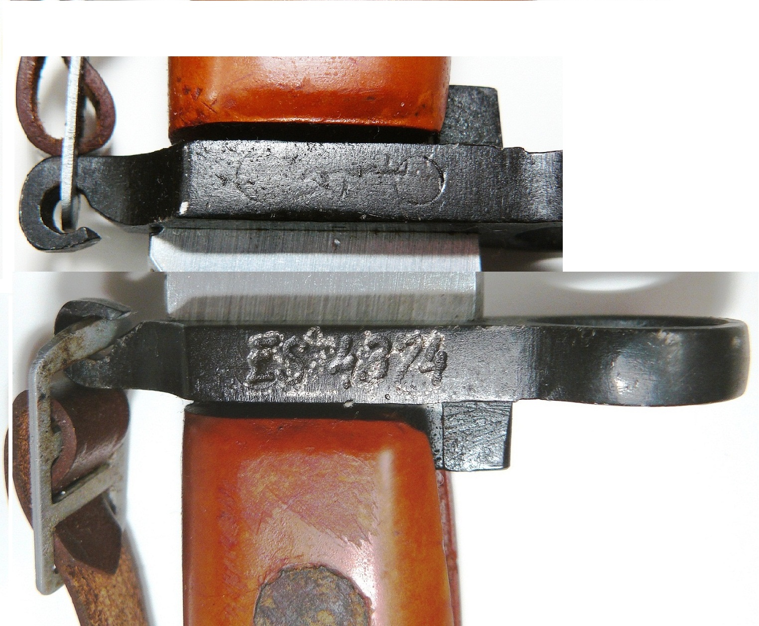

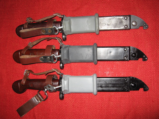

Here are pictures of the wear marks and the correct hanger. Sometimes there are also similar wear marks on the sides of the grip panels from the upper snap hook on the two piece hanger. Mike
