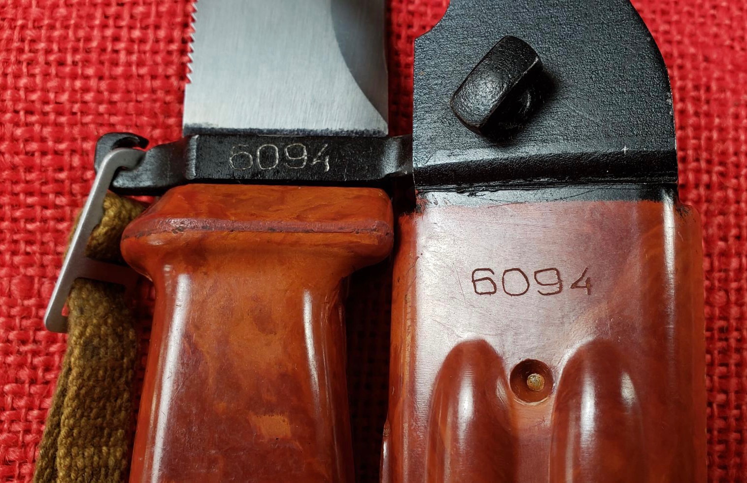

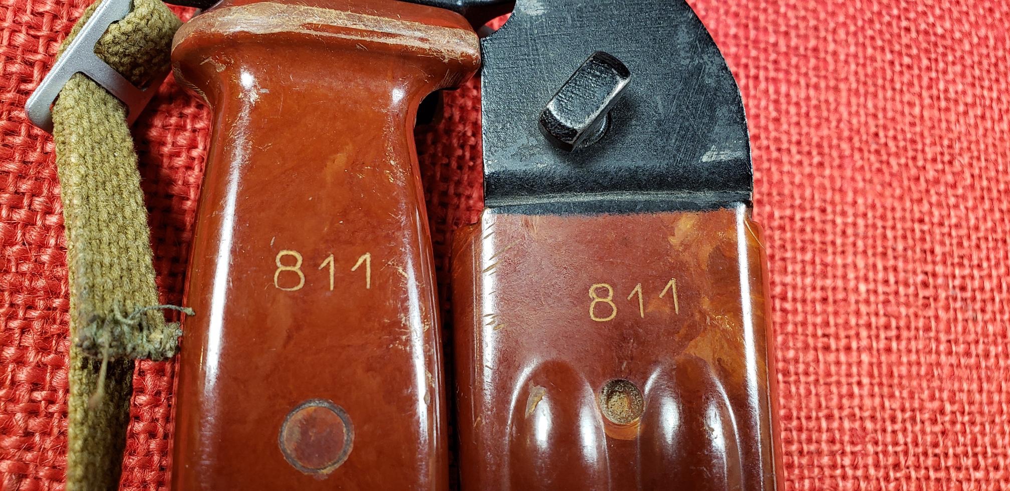

Hi Hans, Yes, the hand etched numbers on bayonets 3 and 6 are what I noticed as being inspected, reconditioned, re-numbered, repaired or replaced. Hard to tell on the others in your picture. Original arsenal matching numbers are machine engraved with block numbers. Located on the front lower space on the scabbard body, opposite side from the molded arsenal mark. The early 6X4 bayonets with the machined (smooth) crossguards had numbers on the left side of the crossguard. Later bayonets with the cast (visible rivets) crossguards had the numbers on the left side of the grip. MIke

Here are samples of 6X4 original Izhevsk arsenal matching numbers. One set is on an early variation and the other set is on a later variation with the reduced pommel. Mike
